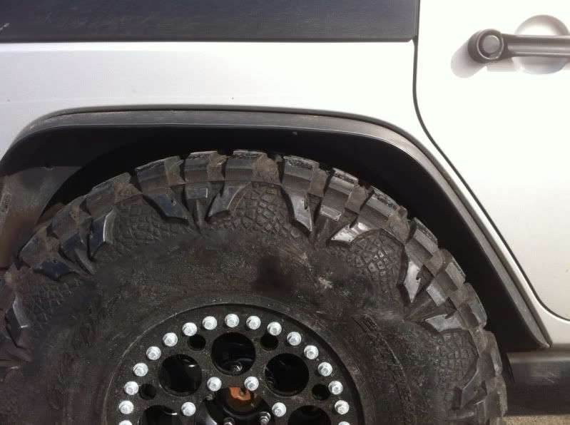

    So where does 40's and a 3" lift fit in with all of this
    This is prior to the second round of trimming...almost on the bump stop

    Quote Originally Posted by Settle View Post
    Well my list includes fitments with "some trimming"...
    This was more than "some trimming"
    Ha ha - keep 'em coming guys! the more the merrier
